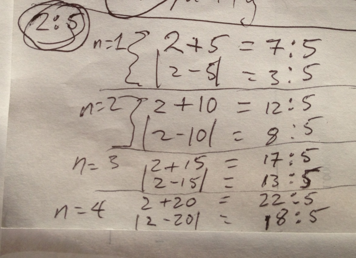

Once the Farey Sequence is in NF, each ratio can then be used (via some simple maths) to obtain a family of ratios sharing the same spectral identity. Truax expands on this and explains the maths in the paper, as well as on the web page. Here is my pen and paper working for the first 8 C:M ratios of the 2:5 family:
Below is an Appendix of Farey Sequence tables useful for FM synth programmers / composers interested in application to C:M ratios. I picked orders 15 and 31, because this fits in well with Yamaha four and six/eight operator integer ratio ranges (i.e. using the coarse adjustment only, and fine set to zero). On Yamaha FM synths it is possible to get to some higher number integers using the frequency fine control, as well as some reasonable approximations beyond the exact range. I include order 9 for easy cross reference with Barry Truax's paper and FM Tutorial web page.
Here is a visual example of one of the ways I've used 3 different spectral families, 3:4 (from the 1:4 family), 3:5 (from the 2:5 family) and NF ratio 3:7 mapped to a parallel modulator algorithm :
The picture back at the top of this post shows one example of how I've used the parallel carrier algorithm. There we can see NF ratio 4:9 and its family member 5:9, as well as the NF ratio 2:9 which is from a different spectral family.
