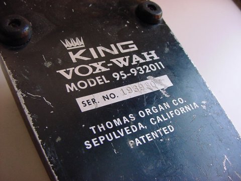

The Technology of Wah Pedals
The stock “wah” pedal has been around since at least the early 60’s. While there is a persistent rumor that an early version of a wah mechanism was found in the wreckage at the Roswell crash site, I can categorically state that the government says that this is nonsense, and that no such thing happened. It was only a weather balloon. Made of … uh… magnesium… and uh… nylon, which was top secret then. That’s my story and I’m sticking to it.
In any case, this thing produces a distinctive tone that is well loved by the expressive guitarist. The history is a bit obscure, but it probably came about as a follow on embellishment of the first Vox mid range booster effects. The nasal tone of the MRB became a vowel-like “aaaahh” with the arrival of a way to sweep the center of the effect.
What a wah does is clear – it is either a bandpass filter or an overcoupled lowpass filter that exhibits a resonant peak just at its lowpass rolloff frequency. The resonant peak can be moved up and down in frequency by the player, and this makes for a striking emulation of the human voice making a “waaaah” tone, or its tonal inverse, “aaaooow”. There are several means to this end, and the circuits are well understood for the classical implementations of such filters with opamps, state variable filters and the like.
